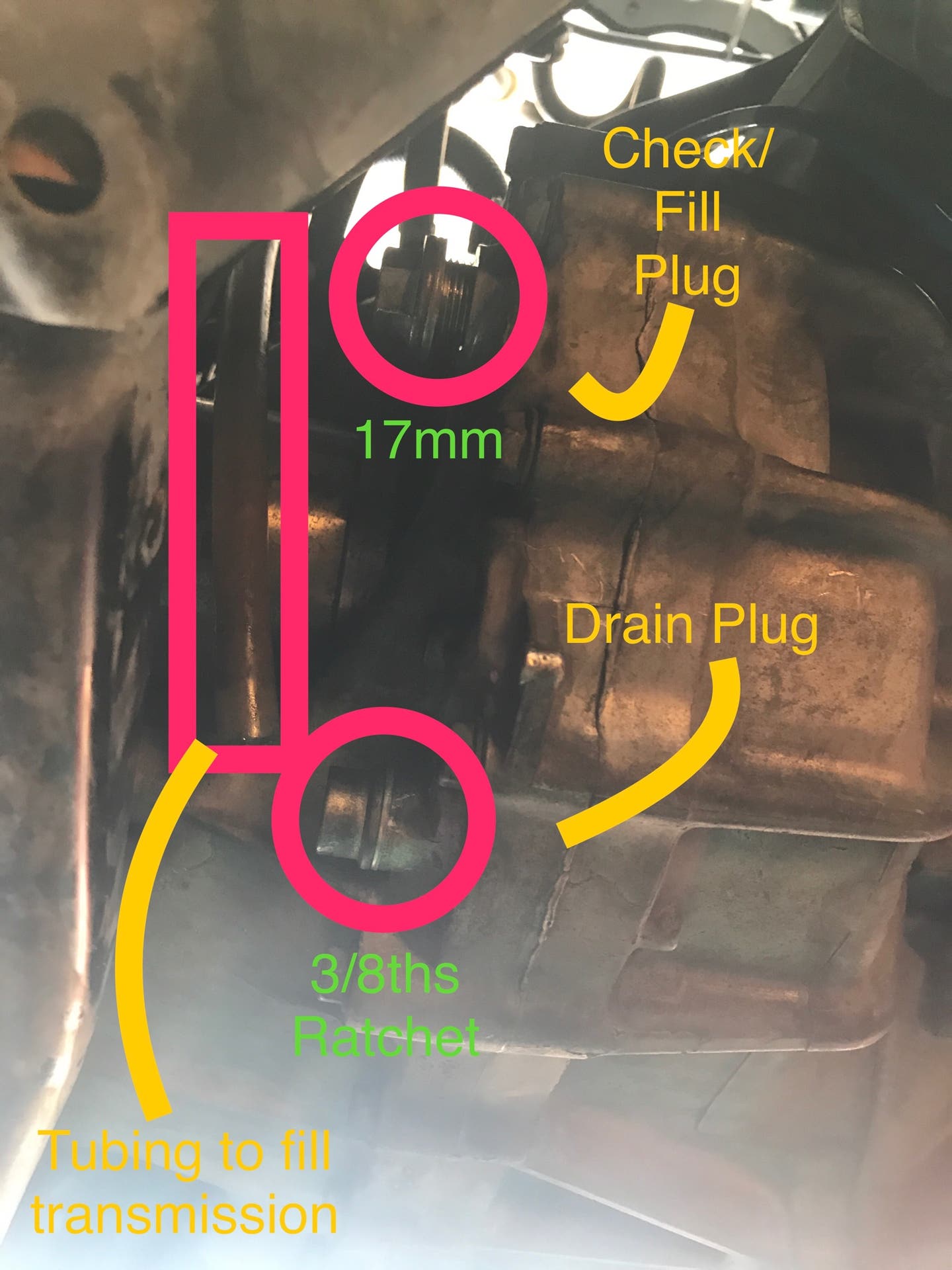

Tools needed:
•Jack along with jack stands
•Clear tubing or Aquarium tubing
•Funnel
•Drain Pan
•3/8ths Ratchet
•17mm Socket
•Your choice of MTF (Manual Transmission Fluid)
•Crush Washers for both the Check/Fill Plug and Drain Plug
I used the Honda OEM fluid. Each quart cost me $7.43 USD. The crush washers were less than $2.00 USD each.
Since I had access to under my vehicle at my job this was a lot easier. First things first:
1. Make sure you have long enough tubing to reach the fill plug. A rough estimate of maybe 3ft-5ft of that should be good.

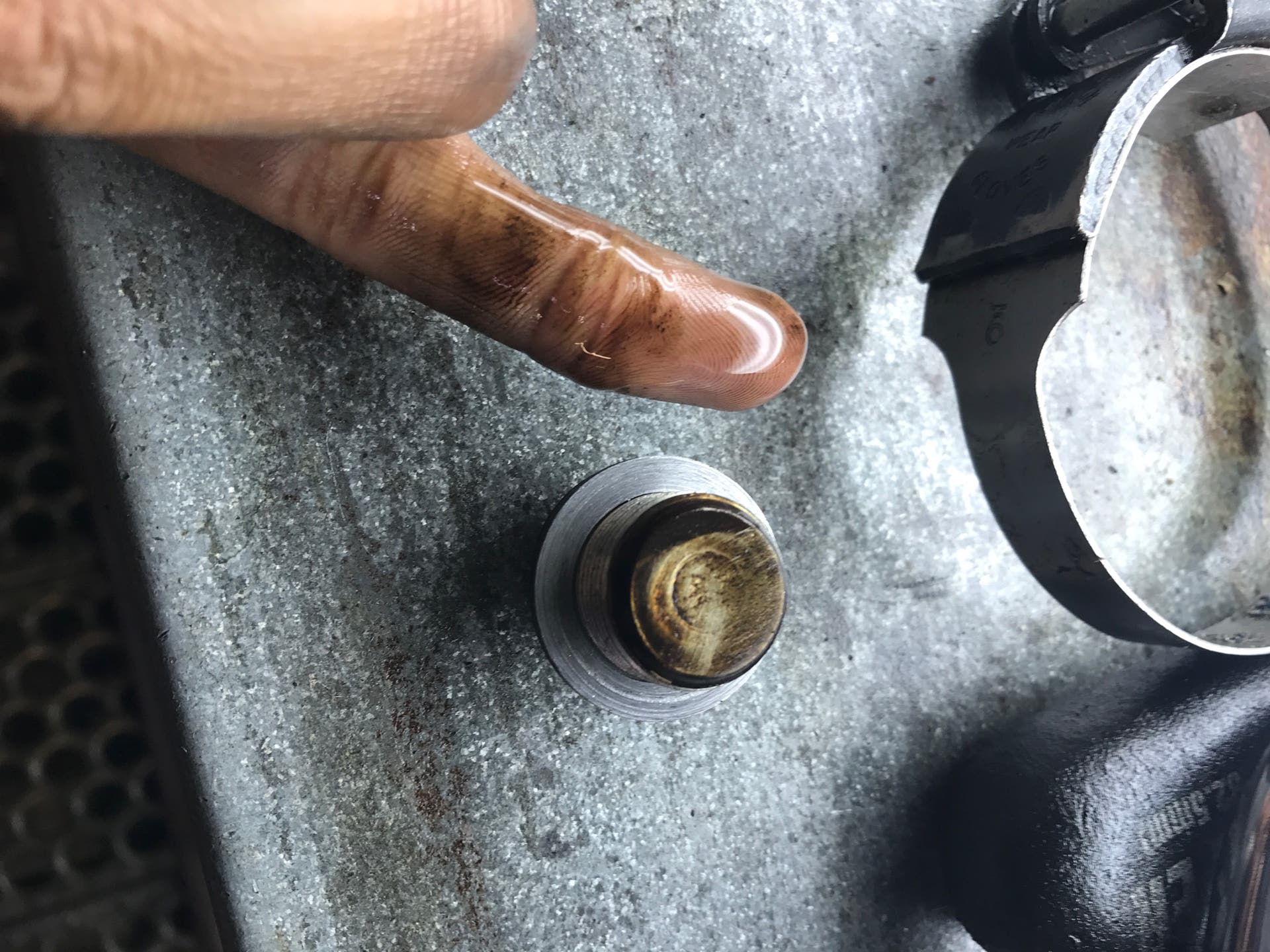

2. Locate the Check/Fill Plug and once located remove with a 17mm socket. If you'd like dip your finger in there to see what the fluid looks like.
3. Analyze the plug & finger to see if it's dirty and that the fluid needs to be replaced. (Mine had not been done since the last owner did it @ 60k :( )

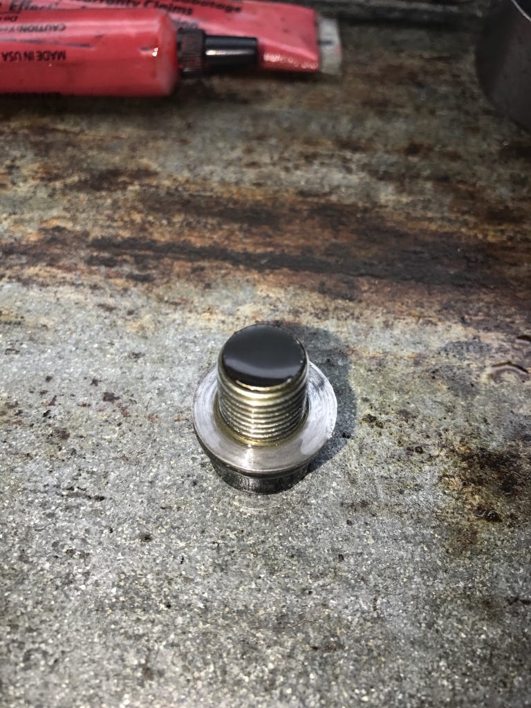

4. Locate the Drain Plug and use the bare 3/8ths ratchet to break loose the plug. I had to use a breaker bar/cheater bar. It will hit the frame by the way so have a catch pan ready.
This is what mine looked like
5. As the fluid is draining open up your MTF of choice and replace both crush washer for the Fill Plug and Drain Plug.
6. Once done draining replace the Drain Plug back in its home nice and securely. Sorry idk the torque specs. Feed the clear tubing into the Fill plug hole securely so that it doesn't come out as your filling it and wasting your fluid. Pour 2 qts of your MTF through the funnel connected to the tubing. Honda OEM fluid was pretty much a clear watery substance in my case.

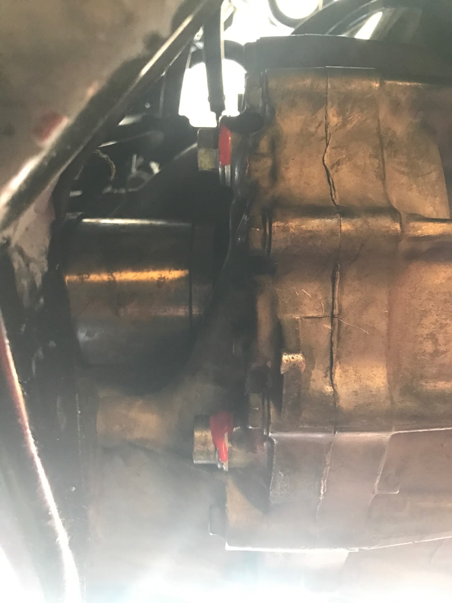

7. Once done filling, place your finger back in the Fill plug hole and there should be fluid on your finger, tighten the Fill plug back in its home. Clean up the area the fluid drained out of, lower your vehicle. (Optional: Get in your car and cycle through all the gears with engine not running 2-3 times whatever makes you comfortable)
I used warranty seal on my plugs just cause.
