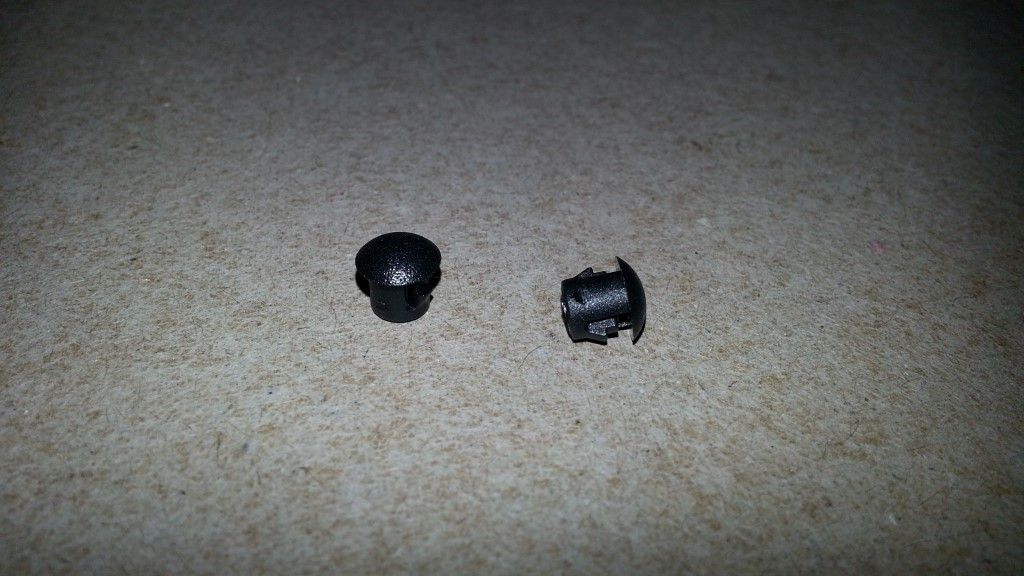

So I totally forgot to negotiate with my dealership to NOT drill holes into the front bumper before buying the car :grumpy:
I ended up created bumper plugs to fill in the holes. This is something I learned from the G35 forums. It's quite simple to do. Here's the before and after pics and DIY. Of course do it at your own risk. I wont be responsible if you get a ticket, go to jail, or cause your car to have salvage title...etc...

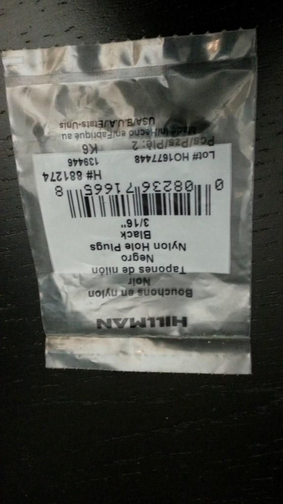

3/16" nylon hole plugs from Lowes for about $1 and change. The size of your holes may be different so check it first.

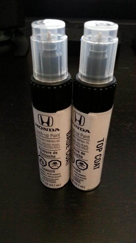

Honda touch up paint. It comes in a Base and Top coat set. Lindsay Honda hooked me up for $16.70
It has a pen tip on one side and a brush on the other.

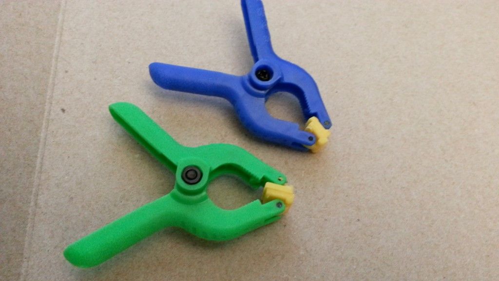

I used these cheap clamps to hold the plugs while painting them. I think it's a buck for a 6 pak of these at Harbor Freight.

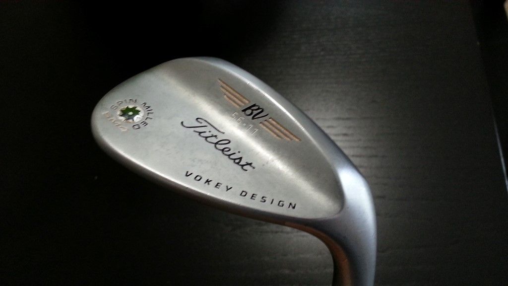

Titleist wedge not necessary for project but nice to have just in case
I painted 3 layers of base coat and 3 of top coat. -Follow the instructions on the touch up paint bottle.

WTF on the wedge? Lol.
