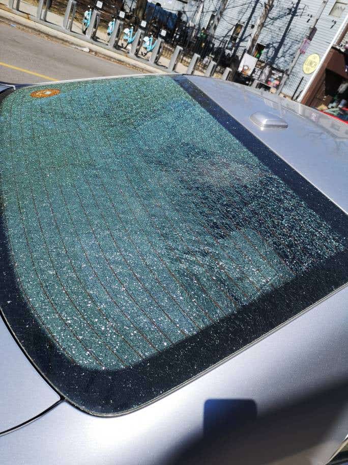

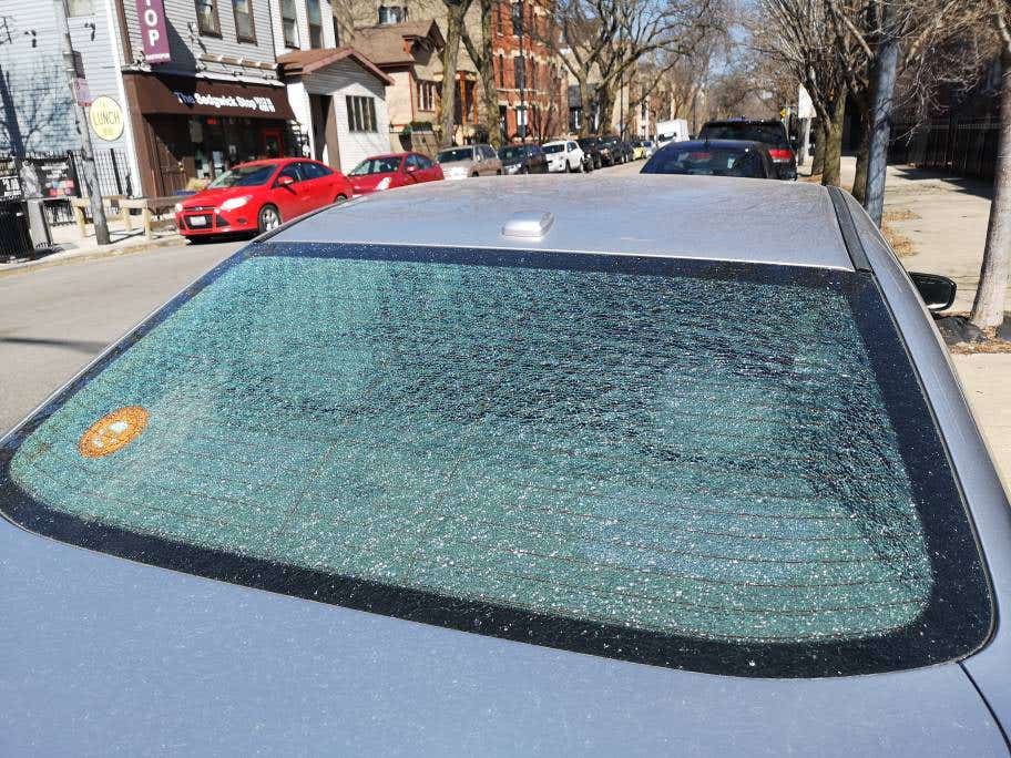

A moment ago, I was shocked to see that my rear windshield is shattered, uniformly, with no apparant impact marks. What possibly could be the reason?
Any tips on how to get it replaced? Experiences? Dealer vs indy etc.

When they replace it ask if they know the cause of it cracking, looks like someone threw hot water on a frozen windshield.

After further examination, I'm convinced that the class shattered by natural causes, definitely not by an object. The cracks are absolutely uniform and the glass stay perfectly in shape, until I slammed the door shut.
There was no defects I'm aware of prior to the shattering. It seems a case of rear winshield explosion.
The only thing I can think of is: temperature and inside pressure. The car is parked facing north, and today is almost the first day of good sun light in a while. The sun definitely had something to do with it. A lesson learned. In the future, I'll try to park in the shade.
Tempered glass can shatter on its own, usually doesn't happen with glass like that (relatively thin). In any case, the size of the defect or impact to cause the glass to shatter can be very small. Quite easy to break with a center punch actually. Should be an easy replace as long as they pay attention to the elec connection for the rear defrost.
