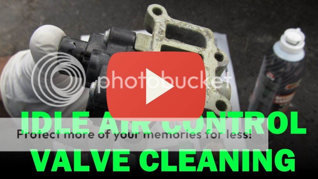

Just to update this thread with my little DIY,
I cleaned my throttle body, idle air control valve and PCV valve. Car runs a bit smoother in drive.
Here's a video on how I did it:
https://www.youtube.com/watch?v=cwo1Hs_0aSI
I did have to remove the throttle body to get to the IACV screws. They didn't want to come out with a screwdriver so I gripped it with locking pliers and got them to break free.
