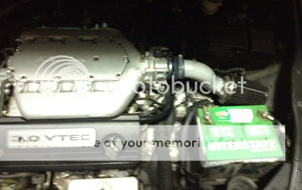

i decided to install the short-ram cold air intake i had on my 90 CRX, onto my 2003 Accord LX V6, because i realised it would fit perfectly, i was'nt worried about the installation, cause i have done it in the past on my CRX and stuff with no problems.
i watched a youtube video of someone removing the stock intake and installing an aftermarket short-ram intake, and i read installation steps for installing an AEM cold air intake also for a 2003 accord V6, and understood everything before doing it.
i removed the stock air box and intake tube, but not the resonator, disconnected the breather hose from the engine and where it went to the stock intake tube, but left the coolant hose connected, which is attached alongside the breather hose, which i left un-connected to anything, just hanging there, since its attached as one piece to the coolant hose, and i just connected the breather hose that came with the CRX intake from the engine and to the intake tube and made sure it was tight, and i tightened the bandclamps where the intake went to the throttle body and where the cone filter attached to the end of the intake pipe, and i was done.
i started the car up, let idel a couple minutes, and went to start driving, and it would'nt accelerate ?, the car moved forward at a slow pace, but not from pressing the gas pedal, it felt as though it was on "auto-pilot" mode or something?, similar to when you're at a stoplight and let go of the brake pedal, and the car moves forward by itself slowly.
now i need to figure out whats causing this problem ???
any thoughts on what it may be would be helpfull,

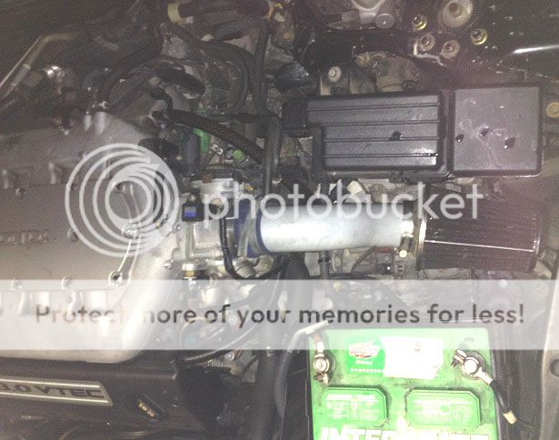

heres some pics of the intake install : (i edited them brighter to see more detail)
Where's the mass air flow sensor?

If you are revving the engine and the engine RPM isn't going up, then you disconnected the drive-by-wire sensor wire going to the throttle body.
And to be honest, you aren't gaining anything with a setup like that. That filter is going to get cooked in the engine bay in no time exposed. Add to that, you didn't remove the resonator so you aren't getting much fresh cooler air from outside. If you want to stick with this setup, then remove the resonator and snake a dryer hose to the front lower portion of the bumper to get cool air.
It sounds like the throttle-body is unplugged. Check engine light on?

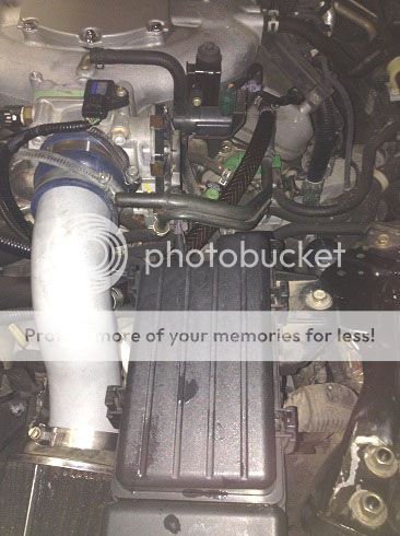

Ok, I may be wrong, but by looking at the 3rd picture, on the right side of your throttle body, the cable seems to be disconnected, (or coming apart).

in the 3rd pic, your probably looking at the stock breather hose thats disconnected, cause it looks as though it connects right against the blue rubber coupler, when really the end is just resting there unattached, and the breather hose i put on connects to the intake pipe further down towards the middle on the right side, but turned slightly towards the bottom, its that hose that has a brownish color with a braided look to it.

What did you do with this plug I circled in the picture? That needs to be plugged into the side of the throttle body. It's a big plug also. Go pop your hood and check. Coming from a CRX, you are used to the old school throttle on cable setup. With drive-by-wire, there is no cable going directly from the pedal to the throttle body. There is no way engine is not revving, unless you disconnected that.
